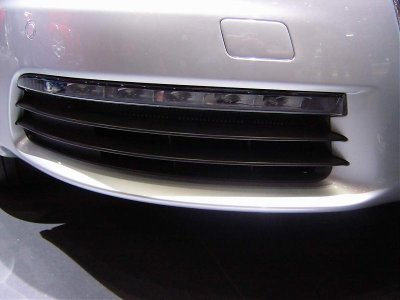

Thomas,
First respect for your car, it is like a dream to me, WOW.
Sorry for my Englisch but writing in Germen is no option for me.
You can answer in Germen but keep it basic please.
I would like to have the S6 TFL like in this picture.
Do you think it is possible on a passat 3C?
Mabe you already answerd a question like this but I dit not read the whole topic becuase the first 10 pages took me 2 hours to read, and understand *oops*
You can find more/bigger pictures here http://www.vau-max.de/galerie/id=310
Thank you for the compliment.
Yes it is possible, i already several Passat 3C equipped with the TFL :D

I was afraid you no longer did it any more bacause it took a while to answer, pffew.
Is it possible to let the TFL only burn when lightswitch is in auto?
So when the switch is on '0' nothing is burning.
Do you have pictures for me how its done on a 3c?
Because I saw pictures on a 3C where they are on the bottom like on your R32 where it looks good, but on a 3C I dont't like that.
This one I like verry much.
