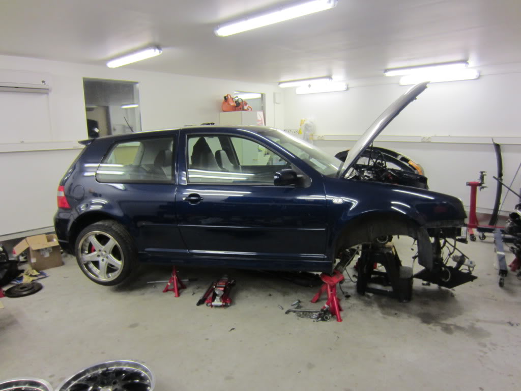

I had some issues with car. Need to take gearbox off and do something to clutch so it have some grip. Also i broke MFA termosensors. So i changed normal manifolds (without holes) back to its place. Also have oil leak on engine , on chain cover. Didnt put sealant on headgasket on there...
Exhaust leaks after catalytic, but i should get new part tomorrow. Cats gives fault code. Wednesday i will get software....
Having some issues on voltage too. Also building my trunk to get amplifier, batteries etc to better place.
As you can see i have extra radiator from DSG and Audi TT

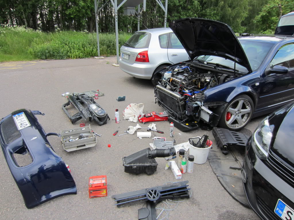

Fixing the oil leak:
Changing oil with my friend who changed rims.
Came from work and lost my coolant, i got 2meters short :)
And lost my fuel pressure under heavy pulls so i decided to change fuel pump:
Now its Rs4 B7 fuel pump.
Result:
