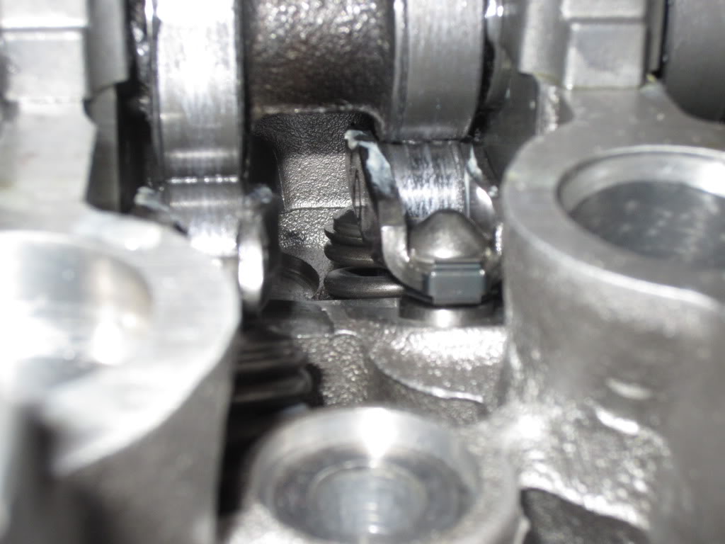

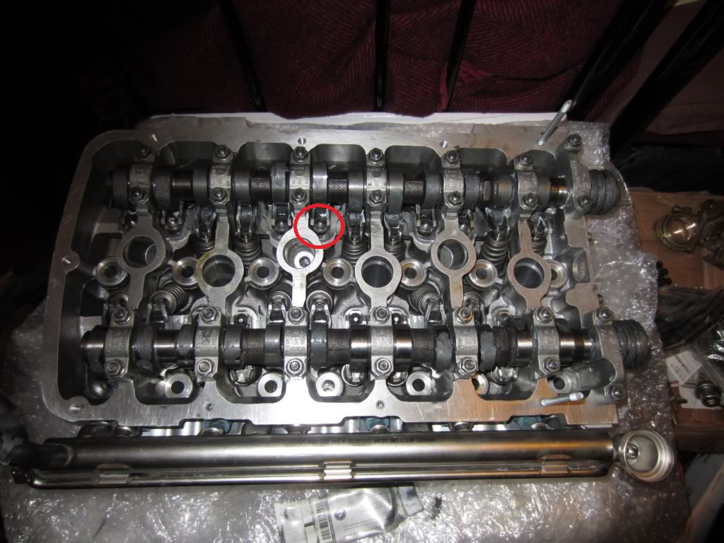

Update, painted some parts and installing camshafts etc to head. There might be problem on head.
and final color
The head one lifter is higher than other:
VS.
Is it problem?

Weiß jemand, ob der eine Ausheber so sein muss (höher als die anderen)? Ich nehme zumindest mal an, dass ein "Lifter" gemeint ist.
Does anybody know, if the position of the lifter (ligter is an error?) is correct?

Yes it was an error, i meant lifter, not ligter :)
Maybe something wrong on number 15...Hmm need to look it better

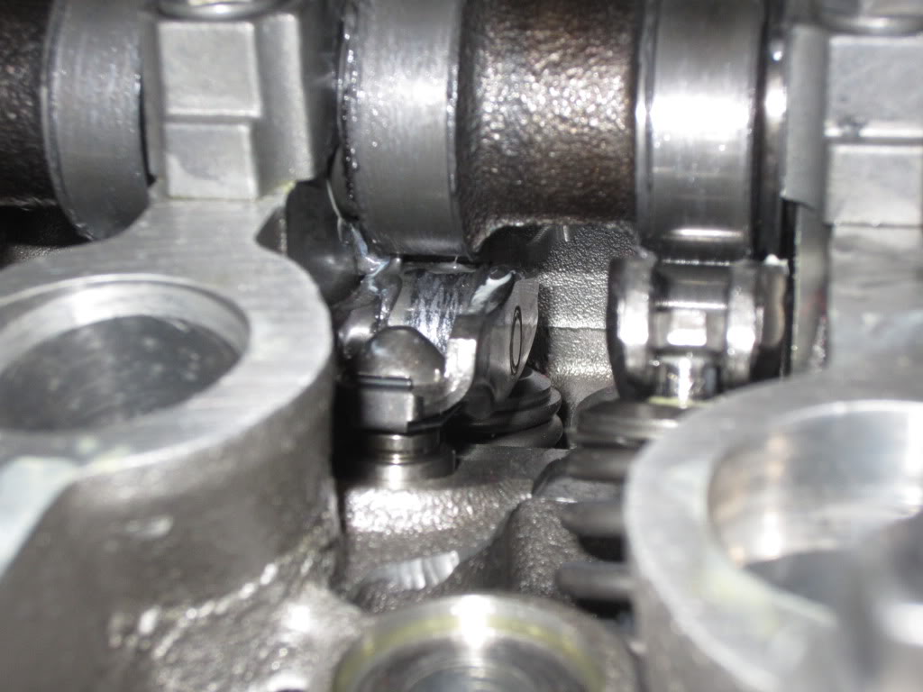

  • My pirate R32 Beitrag #29
When i turned first time camshaft i heard sharp "prin" twise, maybe i broke something :( Or maybe those arent working properly without oil?
  • My pirate R32 Beitrag #30
Just for comparison
Normal
higher:

There is something that keeps spring under pressure or spring have snapped. Is the camshaft too much on left? Do i have right camshaft?
