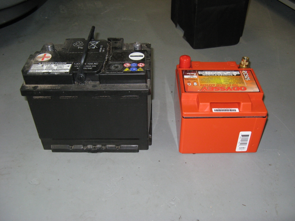

http://www.billswebspace.com/vwr32.htm
http://www.odysseybattery.com/autospecs.html
